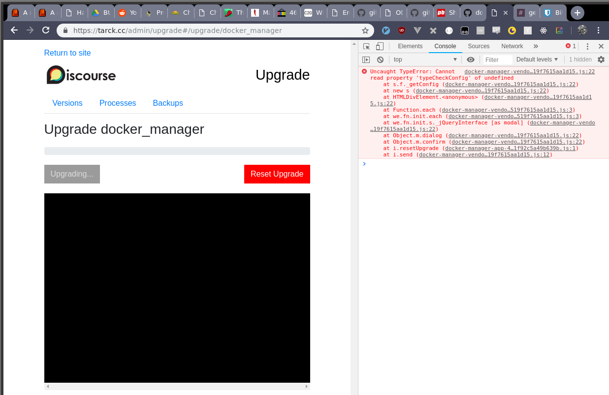

I’ve just tried to upgrade from 2.2.0.beta3 to 2.2.0.beta4 however Docker Manager would not upgrade at all. The Docker Manager screen shows an empty console and ‘Upgrading…’. Pressing Reset Upgrade throws a JS error (see screenshot). There’s nothing in syslog. The machine has 4GB ram & 4GB swap. I ran ./launcher rebuild app and the upgrade worked but I’d love to keep using Docker Manager. Any ideas?

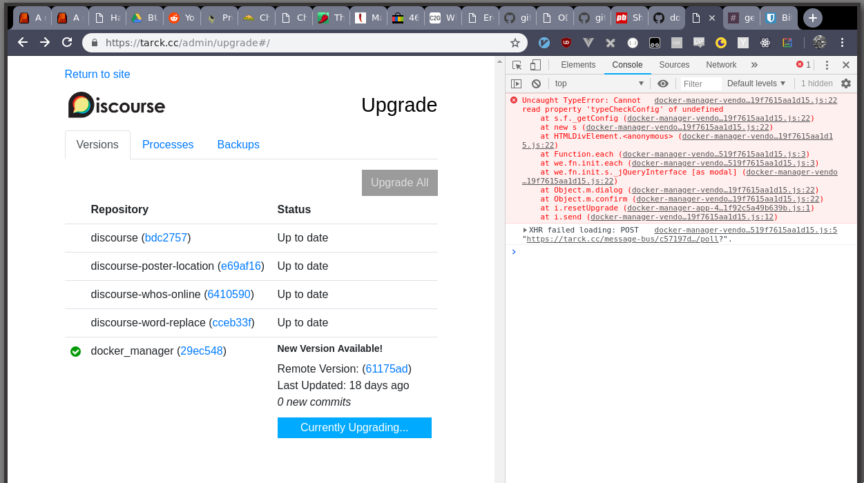

Thanks for the quick reply, I tried ./launcher rebuild app initially and it worked fine going from beta3 to beta4, but Docker Manager still thinks it’s out of date and/or in the process of upgrading?
I just noticed the commit hash for docker_manager is different.
I ran
./launcher enter app
root@tarck-app:/var/www/discourse/plugins/docker_manager# git log --name-status HEAD^..HEAD
commit 61175ada7a1993647878c53320e9c6ffb1076dd2
So the repo is up to date but Discourse is showing an older hash (from Tuesday 18th Sep). I might try rebuild again and see what happens.
Okay no luck with rebuilding the container again. Any ideas?

I had the exact same issue: even after manual rebuild, docker_manager was stuck in “Currently Upgrading” state and the “Reset Upgrade” button was throwing an exception.
I fixed the issue by running this:

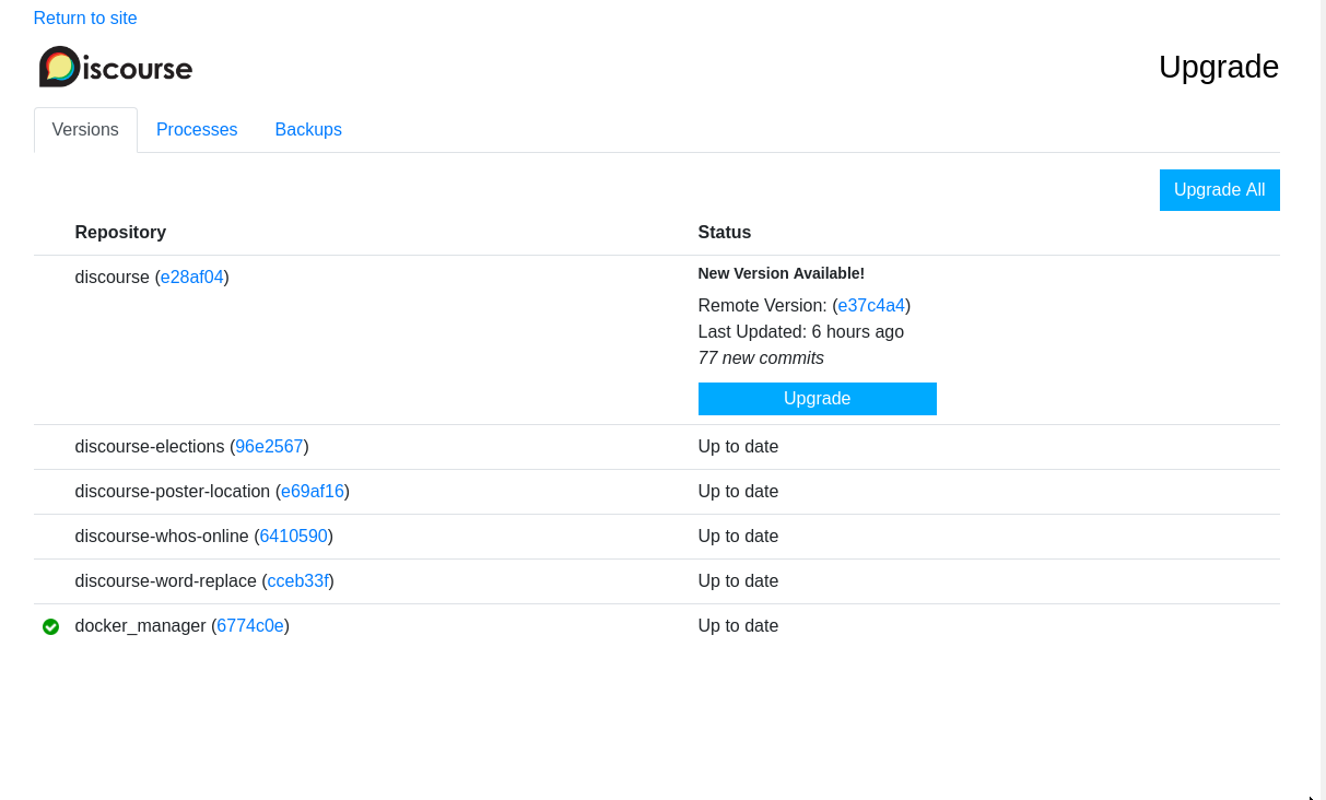

Thanks mate, this worked, can’t believe I didn’t see that post earlier. Upgraded docker_manager to the latest and all is well.
