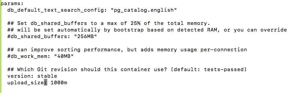

Steps followed:
  1. In app.yml I have set:
    params:
    upload_size: 1000m
  1. I did docker exec to enter the discourse docker and confirmed that /etc/nginx/conf.d/discourse.conf has:
client_max_body_size 1000m ;
