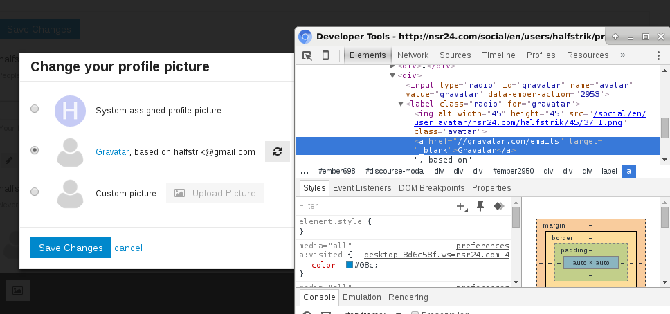

I have a subfolder latest Discourse installation (use official how-to).
I have a Gravatar account and Discourse used to load my picture with subdomain (default) installation.
But when I made a clean new subfolder installation, Discourse no longer loads my Gravatar picture (I keep using same email).
No matter how many times I keep pressing on update button next to Gravatar.
You can check that on my email there is a Gravatar picture actually.
When I try to upload an avatar picture the following happens:
Firstly, picture uploaded, and displayed
But than, after page reload, picture fall back to silhouette of gray fellow.

I’ve installed version 1.5.0.beta6 on my local computer, and reproduce 1x1 pixel blank white avatars.

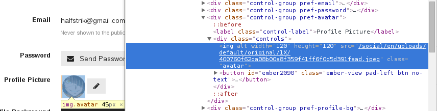

But my issue remains in beta6, when I ulpoad an image, URL to it changes from /social/en/user_avatar/nsr24.com/halfstrik/120/18_1.png to /social/en/uploads/default/original/1X/400760f62da08b00a8f359f41ff6f0d5d391faad.jpeg until I do not refresh the page.
After refresh image URL reverts to /social/en/user_avatar/nsr24.com/halfstrik/120/18_1.png witch happen to be blank 1x1 pixel.
Interesting thing is if I try to load my uploaded avatar, it’s working, so the real problem is with the link, not with the image file.
