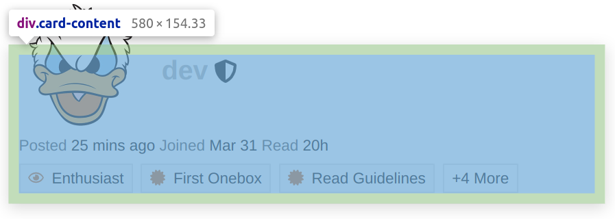

Let’s start with a card with no background on desktop
The card width is 580px and its height is ~154px
