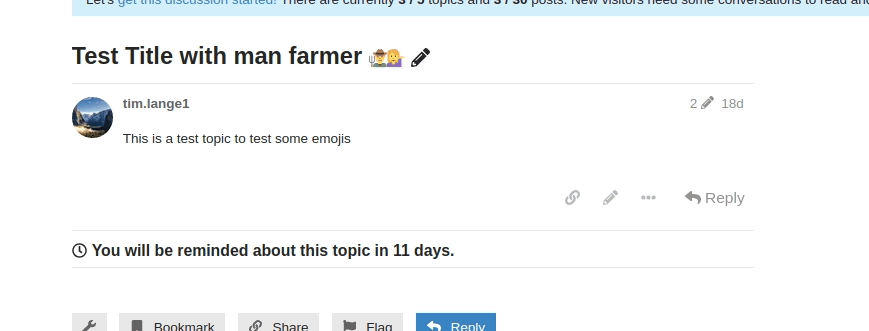

Just opened a PR with a first mockup for this :slight_smile:
https://github.com/discourse/discourse/pull/7380
5 Mi Piace
Does this look OK @sam?
I find the spinner here somewhat jarring:
We should have username/name/title and low res image on the page, not following why we can not start with that?
7 Mi Piace
Because as far as I see here, the user modal gets only called with the username of the user. data-user-card={{username}}. That’s why it only knows the username.
Is there a way for me to get the other information without having to do another request to the backend?
