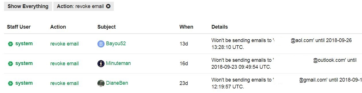

Doubt it helps but couldn’t hurt to mention
I see random system action revoking email in our logs
I expect that happens when emails are bounced, but I don’t think it explains losing group status.
No, it does not explain that, in my case I was able to ask people if they were getting emails and they didn’t seem to notice anything so…
wish you well :sunglasses:

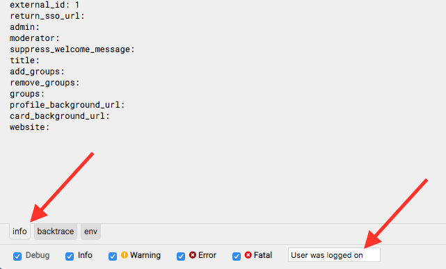

Are you sure that the add_groups and remove_groups parameters are being set correctly? You can check this in your logs by filtering for ‘User was logged on’ and looking at the ‘info’ tab.
(You’re probably right about the expired nonce being a red herring, it doesn’t correspond consistently in the logs to the people who are losing group access.)
The add/remove parameters passed in the SSO payload seem to be setting correctly in the logs, which is even more confusing.
