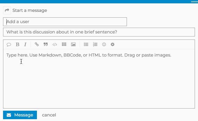

When adding users to a new message, using the @ symbol searches only usernames, not groups.
Is this intentional? Looking back at previous instructions, it seems that we were encouraged to use the @
When trying to send a message to a group, where Everyone is allowed to mention and message the group, you are unable to add them. It appears that if you start with the @ symbol the autocomplete only accepts usernames, even if you add the full name of the group.
If you just enter text however, then the group names do appear

Anyway, I got it fixed. The problem is that the query that gets to the server includes @ which seemed to work fine for usernames (Search.ts_query is pretty smart), but did not for groups.
Fixed by
https://github.com/discourse/discourse/pull/6506

Since they both use the same namespace, should they also use the same code path for search (on the server)?
3 Mi Piace
Currently there is search data for users, topic, posts, categories and tags, but none for groups. Implementing it is definitely possible, but I do not think it is worth the effort.
3 Mi Piace
I see, we should at the very least do the same stripping on the server for those who call the API directly.
And maybe give some (ts_query) :heart: to Group.search_groups as well :wink:
At first I implemented the stripping on the server side, but then I realised it isn’t server’s fault. If the client wants correct results, they should ask the correct questions.
