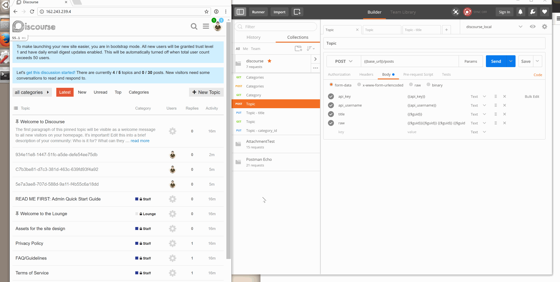

Yes it appears that you need the slug to be present to make the PUT request on topics and you can use the wrong slug and it will work fine.
See my demo:
