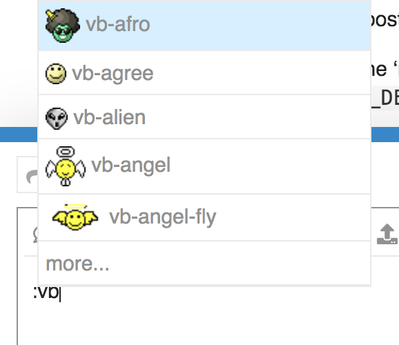

vBulletin Emojis
For anyone who wants to relive the old days of vBulletin and bring back those emojis, have a look at the following plugin (and yes, several of them are animated)
Oh, and they do not interfere with the existing emojione emoticons, as these are all prefixed with ‘vb-’
https://github.com/cpradio/vb_emoji
A big thanks goes out to @eviltrout for his emoji extender!
