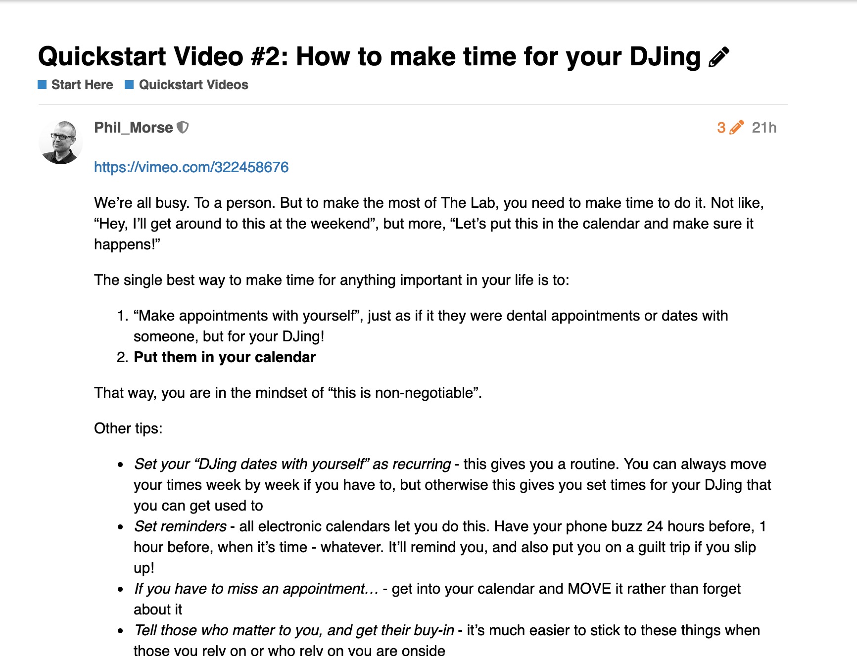

We’re new to Discourse, using the version hosted by you. YouTube videos embed fine, but Vimeo don’t on our site. What are we doing wrong please? Here’s an example of one not working:
Note that the above is what SHOULD be happening (we know the privacy settings are wrong), but this isn’t happening on our site - we are just seeing the URL as typed.

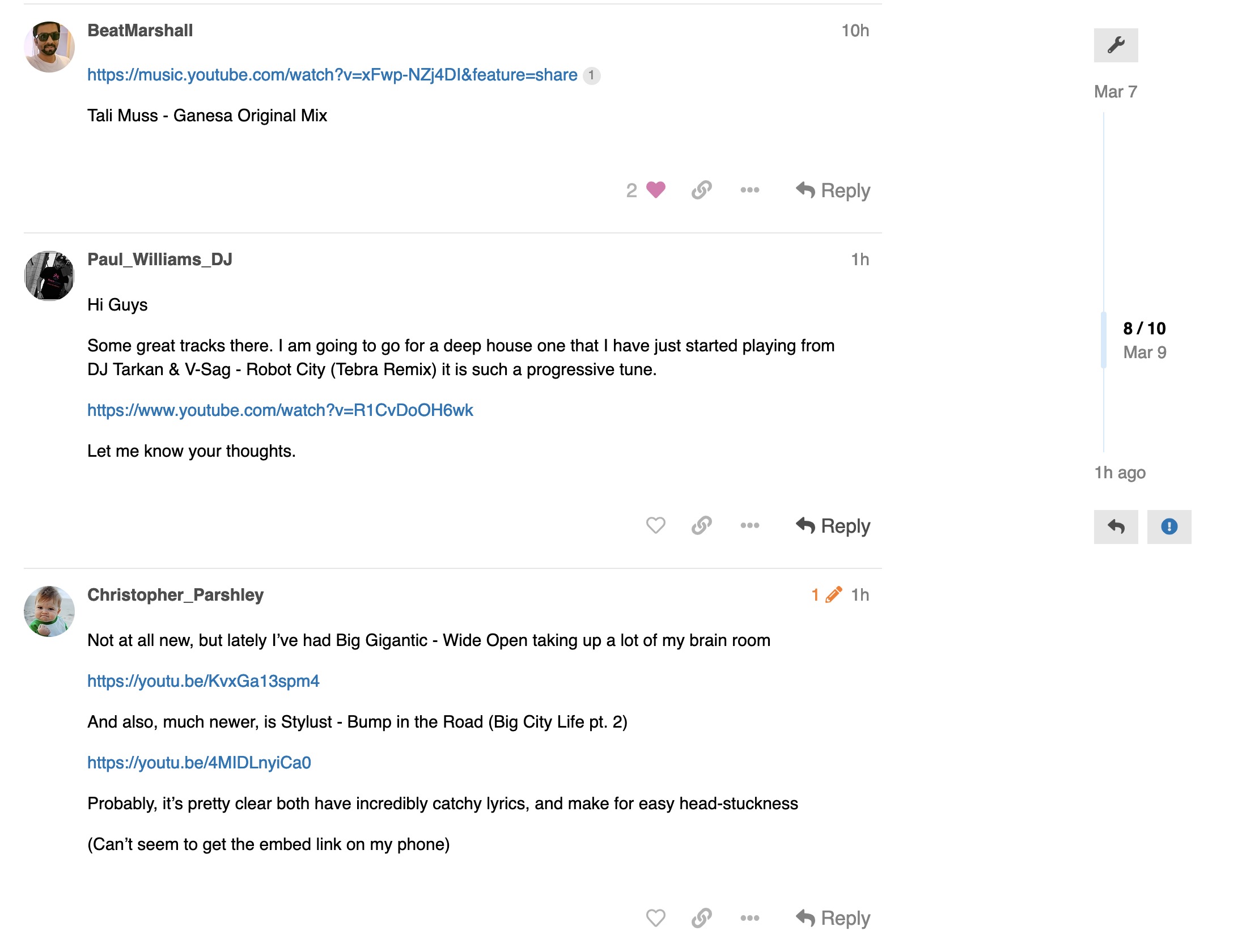

Still not working for us - see attached screenshot. YouTube links embed fine. Not sure where we go from here to fix this?
https://vimeo.com/322458676 is the problem Vimeo link.
That particular URL - https://vimeo.com/322458676 returns a 404 at Vimeo.
True for you, but it is enabled for our website domain so that’s not the issue. Also we now seem to be having problems with YouTube embeds, too - see attached.
