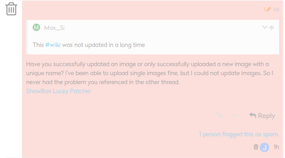

Well it doesn’t happen often and it would be hard to find old deleted post where it did, but coincidentially it just happened again. A post from 4 days ago got edited to add a spam link:
Actually it was more than 4 days between writing and editing the post as it spent about 1 day in the approval queue. It was a bit shady from the beginning, so we didn’t know if we should approve it, but then we decided to “see how it plays out” since we didn’t have enough evidence to kick them right away.
Anyway I guess your suggestion of abandoning the grace period for TL0 users is probably a great solution.
