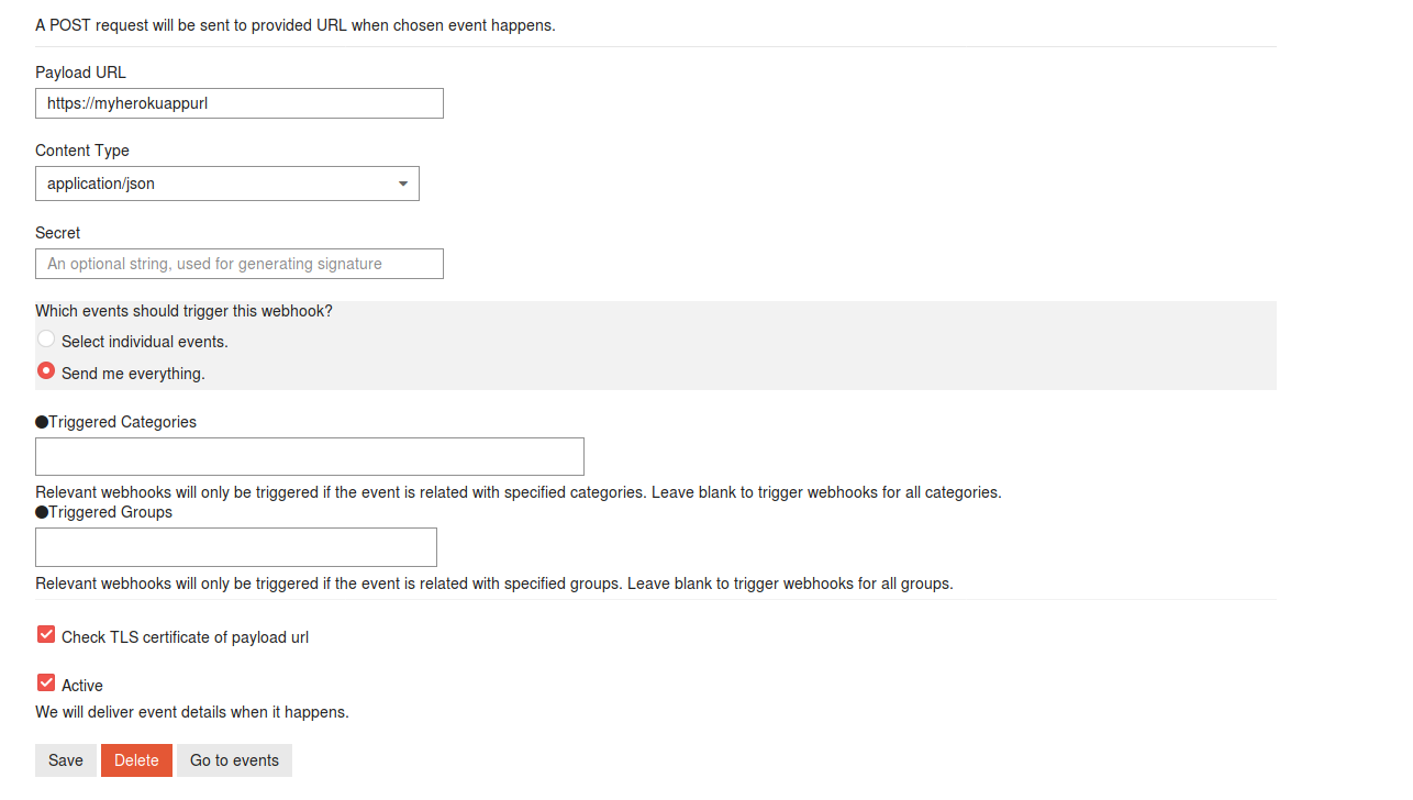

As you can see below I have pretty much set it to send me everything though I have tried limiting to just topic and post actions as well.
