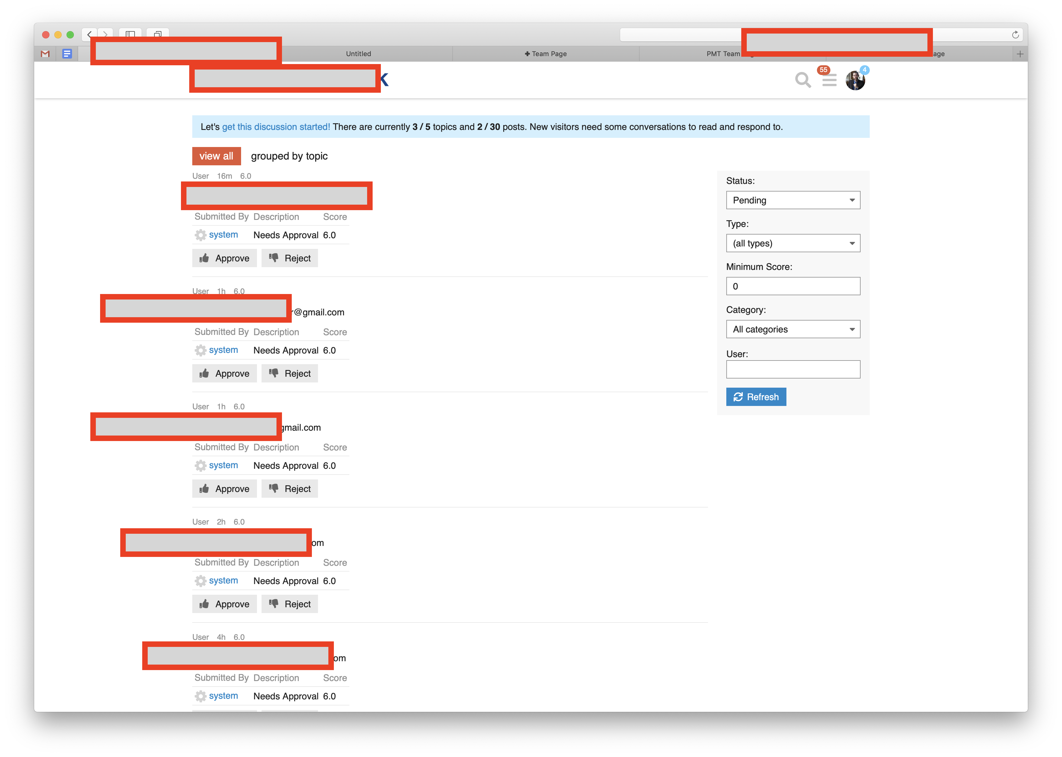

I am receiving a deluge of approval requests and I don’t understand why.
These are called “flags” according to the constant emails that I get telling me that I need to pay attention to them.
When I review the “flags” they are classified with the description “needs approval”. No further information is available. I’m not sure in what facet I am “approving” these things, or what it actually is that I am approving.
Either way I am pretty sure that I am adding zero value as an administrator because I just click 100% of the approve buttons.
I am not expecting to approve anything. If these are related to new user registrations on the forum and granting them permission to be a user, then this is unexpected as well. Below is my current setting for new user accounts.

Please see Feedback on the new Review Queue (2019) and update your site to the very latest version of Discourse. If the problem occurs again, report it on the appropriate topic
I have the same problem on two sites, one of which is also login required, so all users are approved before they can log in as reported here. I upgraded the site yesterday, so it’s pretty darn close to latest.

Can you check if the invite only setting is enabled? It’s the only thing I can think of that’s forcing you to review users. If must approve users is off.
Hi, I’m using SSO to create users, have “invite only” checked, “login required” checked and “allow new registrations” unchecked. Before beta6 the new users were created fine on first login when logging in for the first time via SSO. After I upgraded to beta6 (didn’t manually changed any settings) I have started to see these approve users. I assume the users are not created now before I click approve. I don’t understand where the change came for, and how can I keep creating the users at first login without manual touch. I only want to allow users of our external system to login. I will keep following this post, and can post extra information if needed. Thanks!
Checked for user information in the table, and it seems the users are created already earlier as I can see data in “seen” column pointing to the time before pressing approve and some read topic counts. So I’m not sure now what am I approving or why the users show up in the approve list.
These settings are incompatible. There is a fix if you update Discourse that disables the setting and prevents it from being enabled.
