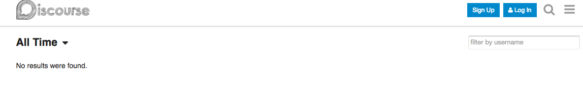

Why does the user list remain empty?
I have a fresh Discourse installed on DigitalOcean (followed ssh instructions)
After creating 5 users, and visiting /users page it always “No results were found.”
What could be wrong? This happens for both logged in and logged out users. Also settings box is ticked to show users list.
What TL are the new users? I believe it filters out TL 0 users. Plus that page is very heavily cached and requires a job to run in Sidekiq (IIRC)
They are a mix of users. Some are even admins.
Like @cpradio said this page is updated in a background job. I would ensure sidekiq is properly running and wait for 24 hours for the job to run.
regategorizing as #feature, it is working as designed, there is a delay there. If you want it any faster there is a huge and complex cost involved.
