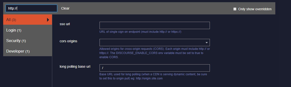

Search site settings for “http://”.
You might also have forced the image in a custom theme.
Thanks for your reply!
This is what I get:
Not sure what you mean by that. I’ve just created a new theme and added the logos, icons and favicon. All via admin settings/dashboard. That’s the only resource served via HTTP for whatever reason.
