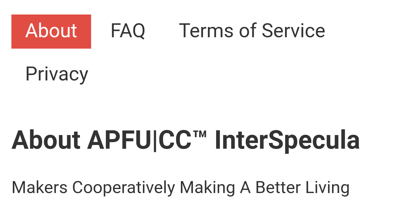

I would like a Permalink next to the About that would reveal the WordPress Blog in Discourse clothing. Some hack that pulls the automagically generated WP Pages and populates a submenu like that of the About.
