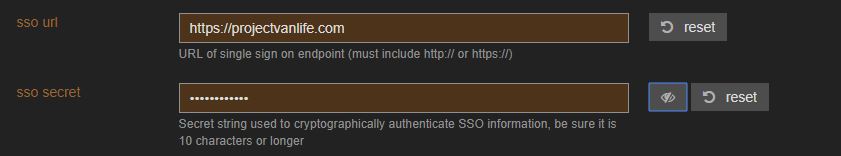

Is this what you mean by that:
And I don’t see a + icon anywhere either
