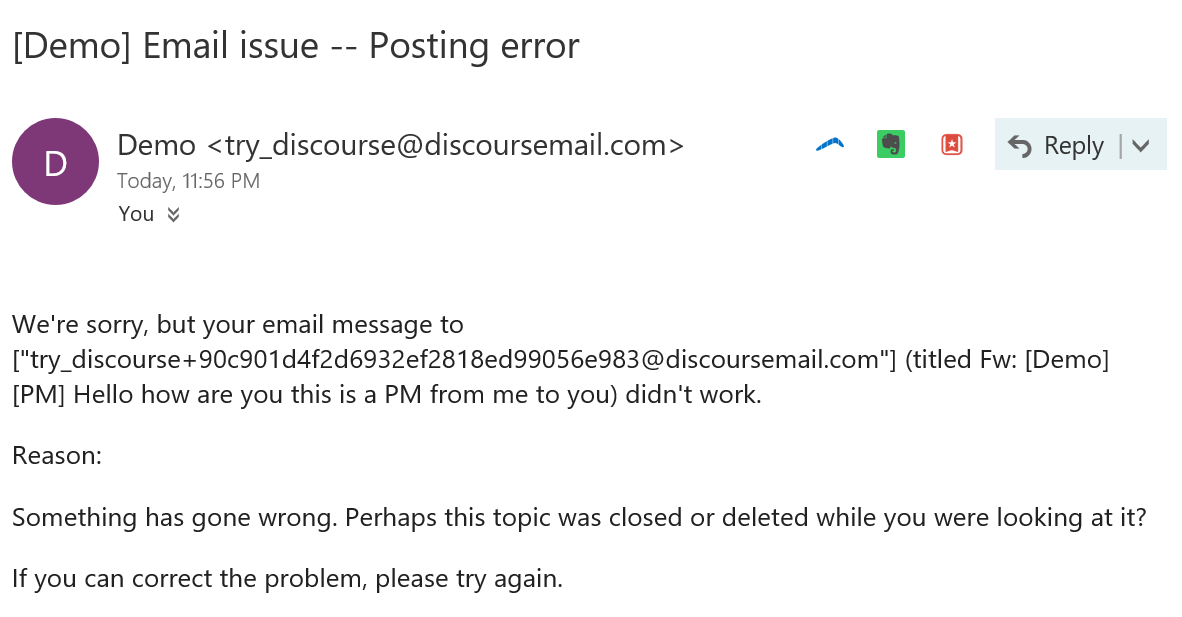

A user just forwarded me an error message he received when he tried to reply to a PM via email. From what I can tell, the reason why his reply-email was rejected by discourse is that he used a different email address than the one he’s registered with on discourse. But the error message he received read
Something has gone wrong. Perhaps this topic was closed or deleted while you were looking at it?
with the subject line:
Email issue – Posting error
Apart from this obviously being the wrong rejection message being sent, I am also confused where that message comes from in the first place. I can see the text content element topic_not_found with exactly that text, but the email template Email Reject Topic Not Found (where I’d expect this copy to be used, based on it’s name) is entirely different.
So I’m not sure what’s going on, but something is wrong.

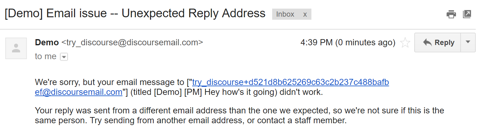

You lost me there. I don’t know how the software does it, but I see an email templates called Email Reject User Not Found which tells the user this
Your reply was sent from an unknown email address. Try sending from another email address, or contact a staff member.

I can’t repro this.
  1. Sign up on try.discourse.org with a new user
  2. Turn on “email me on all messages even if I am here”
  3. Send a PM to this user
  4. Get email
  5. Copy reply-to address and paste it into a new email from a totally different email account
I get a proper email response

The steps to reproduce are slightly different. Instead of merely copying and pasting the reply-to address into an entirely new email, you have to reply to the actual email you received so that all the headers are included. So, technically speaking you have to either set up the new user account so that it forwards emails to another account or you need to be able to switch the sender address in your email client when replying.
I was making the wrong when I assumed earlier that the message is rejected because of the wrong sender. The actual rejection email type is: email_reject_invalid_post_specified.
3 Me gusta
I was able to repro by forwarding the original mail to another account (random outlook email address I have), then replying to that mail but editing the reply email address to be the correct one – rather than the person who forwarded the email.
Net result, original email was included in the body.. versus a blank email sent to the reply address.
Can you look into this @zogstrip? It does seem something in the actual forwarded email is triggering an incorrect error here, and incorrect errors are very bad..
