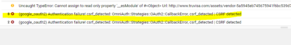

  • User tries to log-in with Google OAuth. User cannot log-in.
  • CSRF error is thrown by Google o-Auth

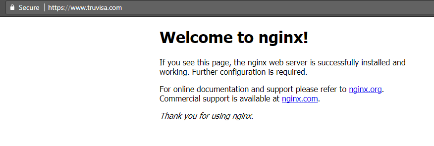

I tried adding the above rule to app.yml file inside after_web_config and rebuild. It, then shows the nginx welcome screen

Can you help with right way of adding this http_x_forwarded_proto rule to discourse?
