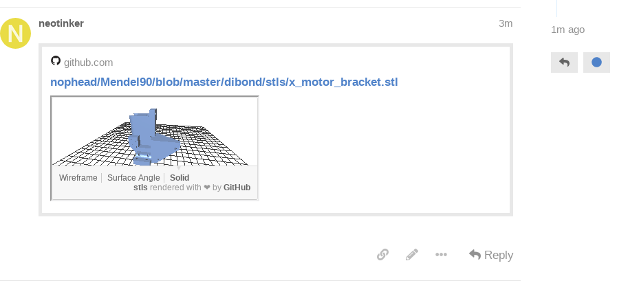

I’ve modified the onebox github_blob engine to display the stl model file using github’s render url.
https://github.com/discourse/onebox/pull/401
This is my first attempt at modifying onebox. Feedback is welcome.
I’m testing with “Mendel90/dibond/stls/x_motor_bracket.stl at master · nophead/Mendel90 · GitHub ” but that repo is full of stl files that you can test with.

12 Aprile 2019, 3:19pm
7
The current version does nothing to set the size of the iframe window so the rendered model is fairly small.
I initially thought that was ok since clicking on the link will take you to a page with a larger version of the rendered model but now I’m wondering if the embedded display should be a little larger.
Looking at the youtube plugin, it uses 480x360 which seems like a good size.
It makes me wonder if I should set the default size to 480x360 or leave it as it is.

13 Aprile 2019, 8:37pm
8
As someone who creates models and intends to use this feature, I think that the 480x360 is a more meaningful aspect ratio for interactive content like this.
