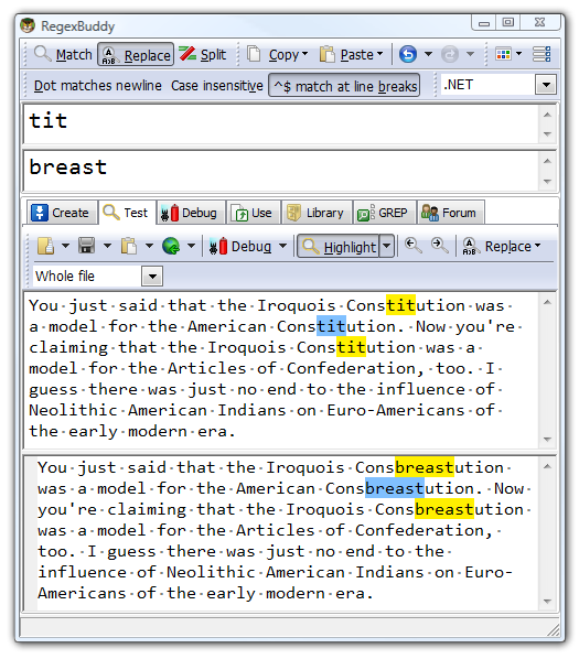

Fair enough, but the filter already exists in Discourse, even if you aren’t using it personally. Also, keep in mind (in response to your blog post) that the Discourse filter doesn’t replace strings, it masks them with squares. :slightly_smiling:

Actually, last I knew it replaces the characters with the box decimal value
eg. blocking “@gmail.com”, “someone@gmail.com” would look like
someone■■■■■■■■■■
and the source would be
someone■■■■■■■■■■
That is what I meant when I finished the sentence with:
Forgive my error of specificity. What I meant was that it doesn’t replace it with other letters to change the word, as described in the blog post above. :wink:
