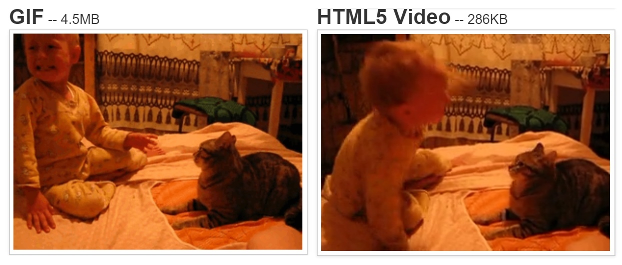

I think converting animated GIFs to MP4s is way more practically useful than this in the near term.
The average animated GIF would be a lot smaller than 66% of the size when converted to MP4.. a whoooole lot smaller.
  292,891 AlertSpicyBlueandgoldmackaw.mp4
That’s 16.2 times smaller…
