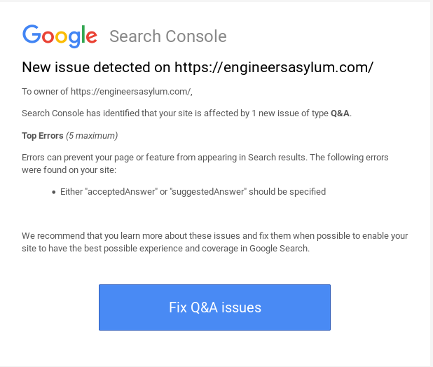

I think I’m seeing the same issue, this just popped up on my search console today
Either “acceptedAnswer” or “suggestedAnswer” should be specified
So far it’s only showing up 1 page with the error

I am also have this problem with my site. Got a mail from google webmaster!!
